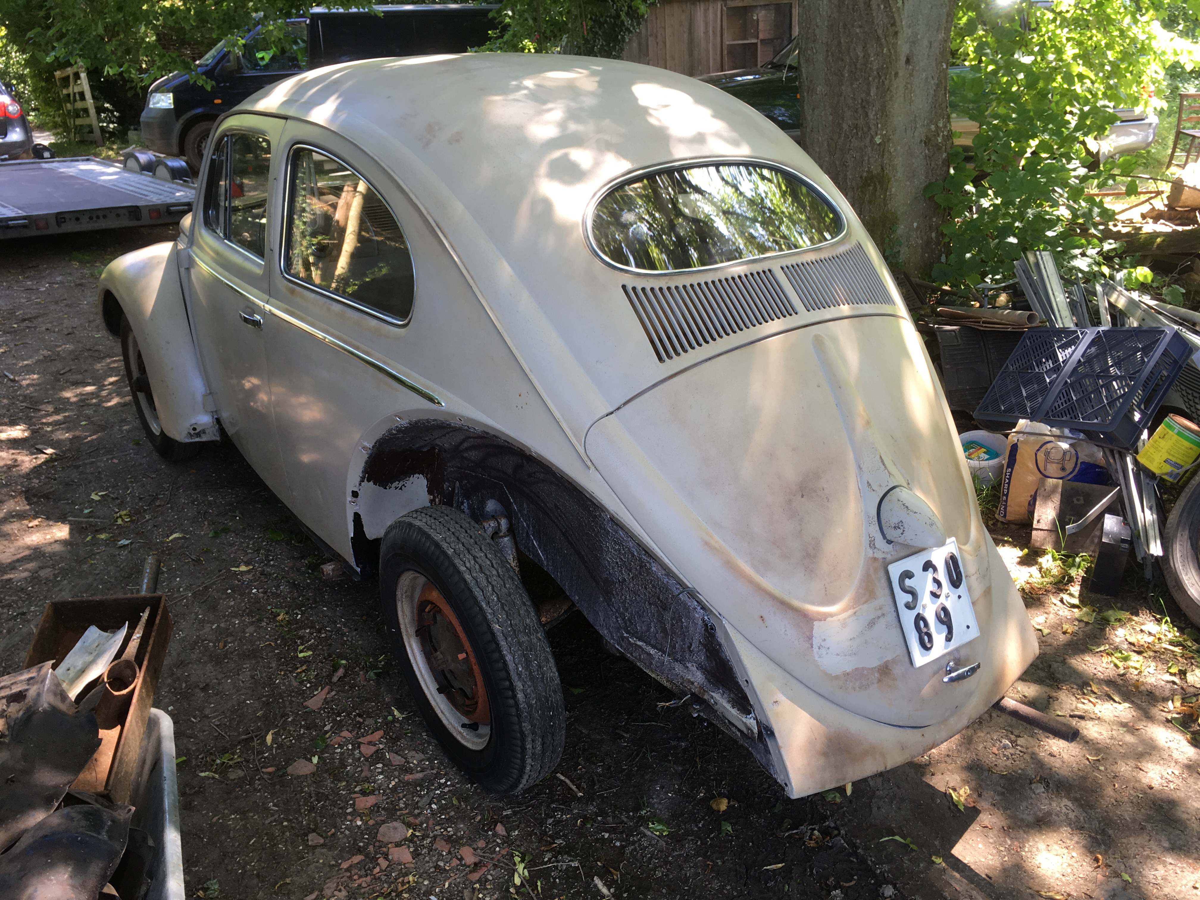

I sold my 68 Beetle and couldnt decide if I should use the ££ to get my split finished or buy a stock Beetle. I wasnt looking for a project really but I found a really original 55 Swedish Oval and wasted all my money (and more) on it... So Iv got a small project to keep my busy at home now :)
Kinda feel like my mango is sliding down the priority list even further :S

blink
Posts: 82
Joined: Sat Aug 22, 2009 9:16 am
Re: Mabbo's 1960 11 window full restoration
Post by blink » Fri Jul 27, 2018 12:43 pm
Looking forward ti seeing some more work but that oval looks awesome
You will have to put some more photos of that up as you go.
Keep up the good work/buying more projects
