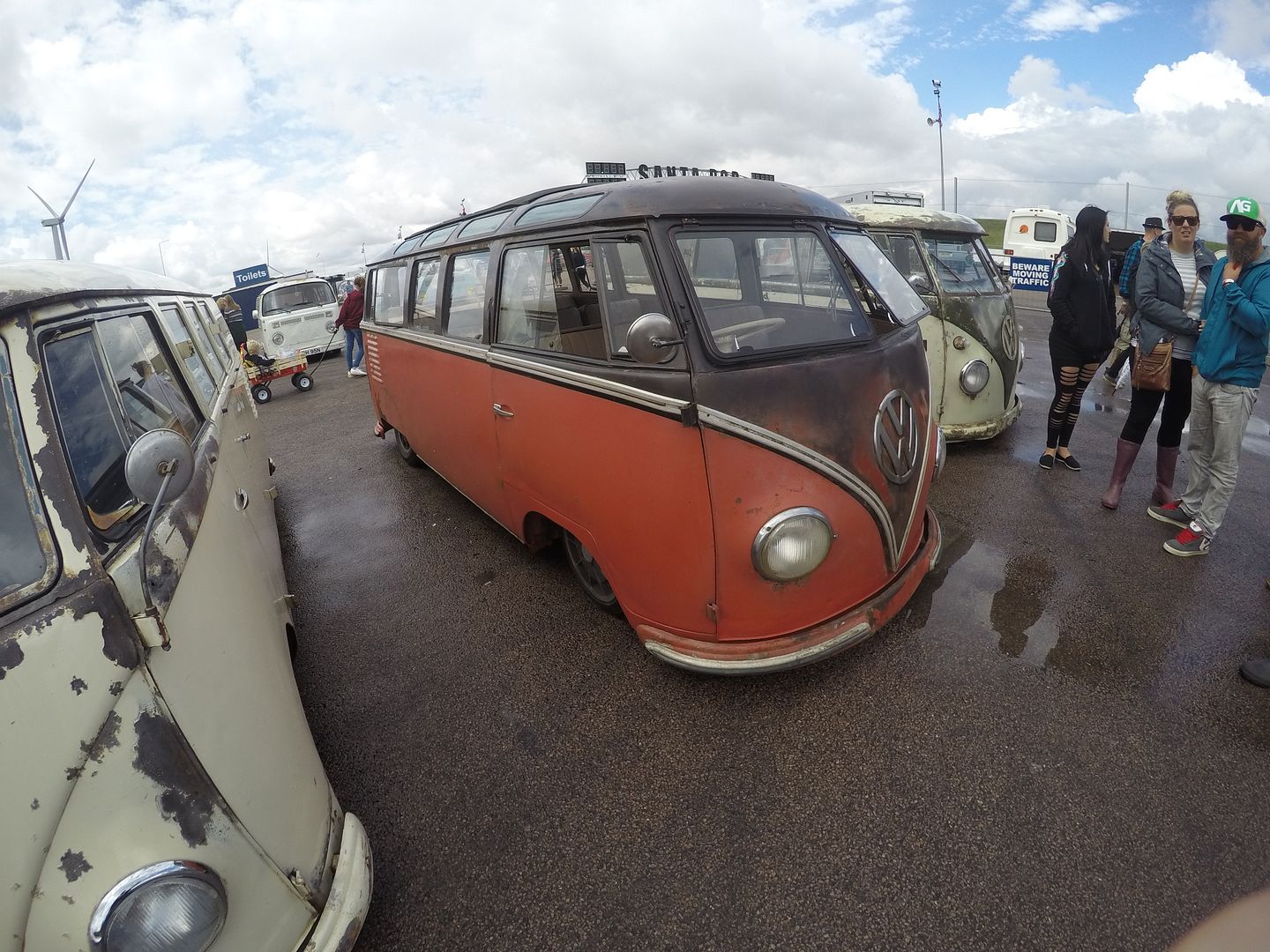

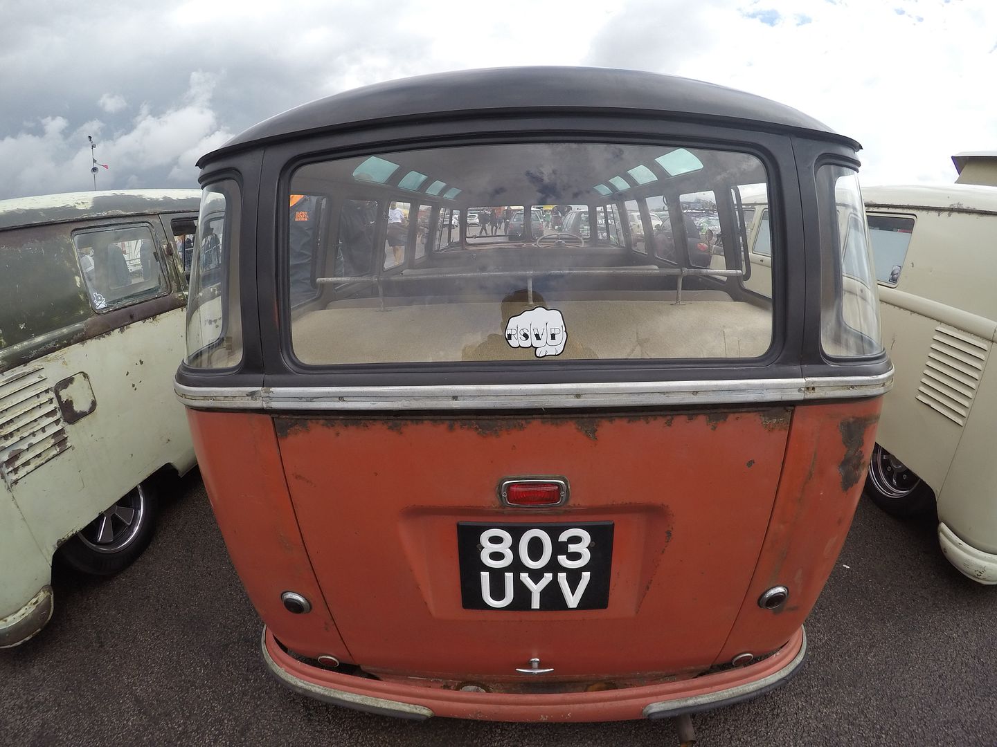

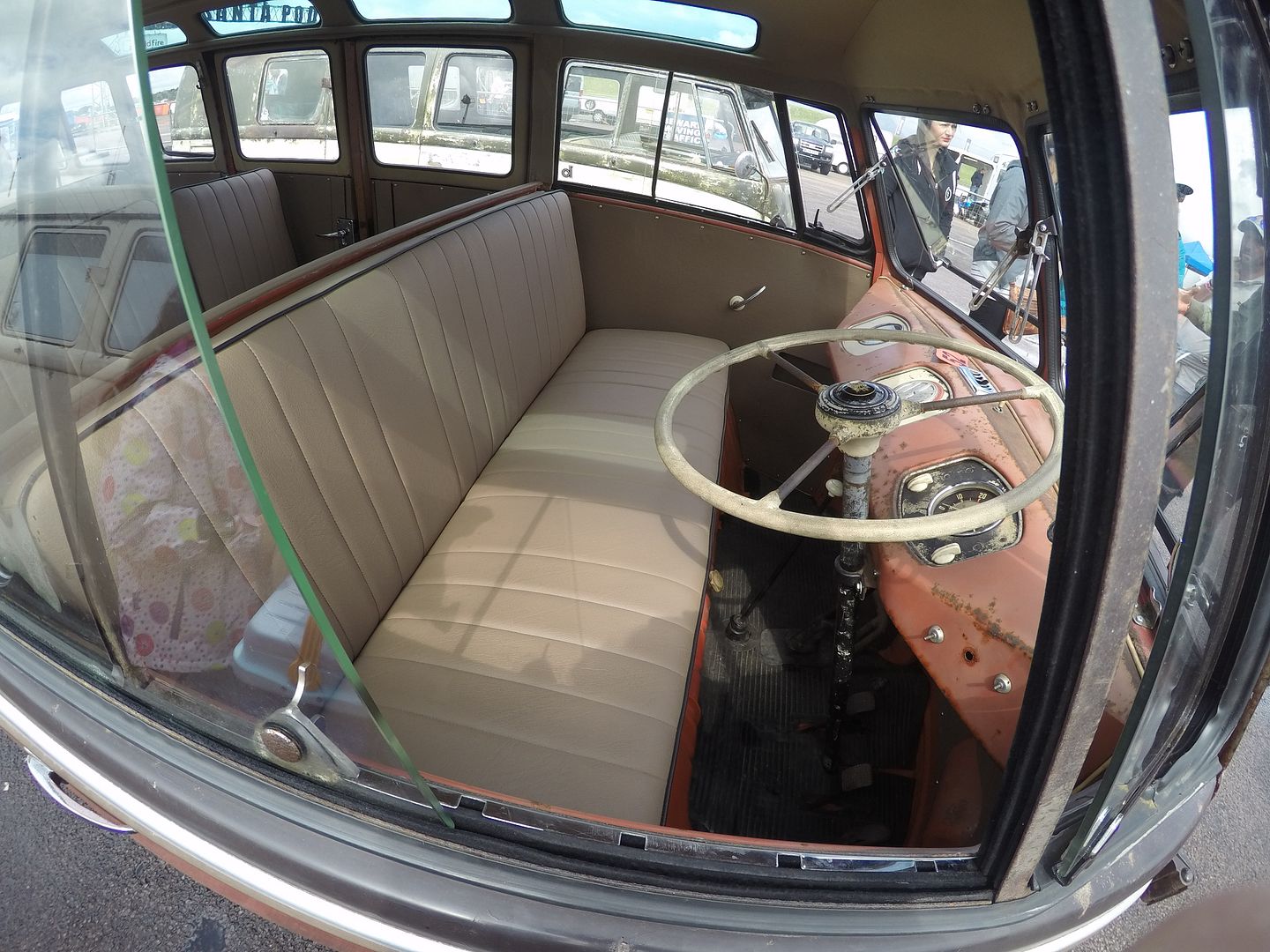

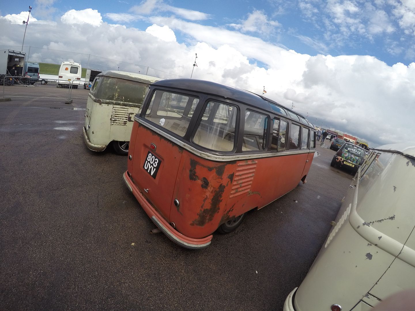

Went up Pod on sunday, very disappointing weather... but was super chuffed to have a look round your bus.
Few pics:
Awesome.
