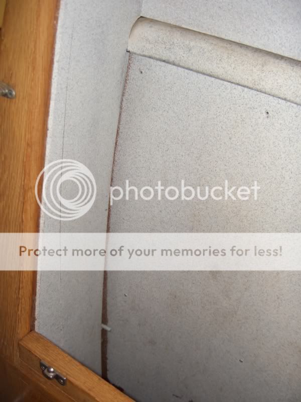

Yes Bulkhead Cap.....it is a just an added pressing! Not screwed on...
It is just clipped over the division square edge and is easy to fit but darned hard to unclip...I'm sure my 64 is bent now..
VW covered them with vinyl and the finisher inside the cupboard is 3/8ths ply rivetted to the division. The inside of the cupboard was then sprayed with white + blue flecked paint...as in my photos above...
It just gives a neat clean finish inside the wardrobe...
Someone on here will have a body being cut up and there will be one available...
Rippers has confirmed that he did find one!
I think these were an added finishing touch to microbuses.
