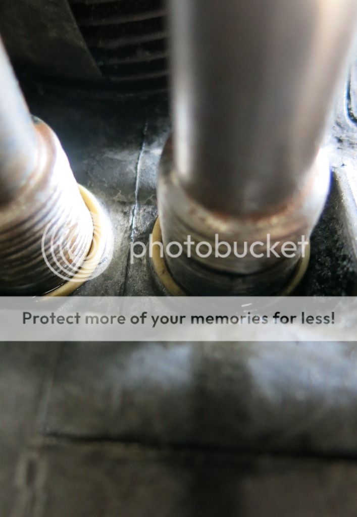

Thanks for the replies. Yes the air filter element was the same and has a breather pipe connected. It is a stock bottom pulley. The oil is leaking from behind the pulley into the little cover plate and some is being flung around . Do you think if the valves have been set too tight it would cause this? I will get a picture. The pushrod tubes are dry. Thanks Phil
Sent from my SM-J320FN using Tapatalk
philsparks
Posts: 258
Joined: Wed May 21, 2014 7:55 pm
Location: new forset
Re: Oil leak
Post by philsparks » Sun Jun 18, 2017 1:10 pm
Pictured the oil is leaking straight down from the plastic tray on the muffler

Can't think how the valves would have an effect on that. I'd take the pulley off and check that the outer thread is clean, then reinstall and see if the problem goes away.
