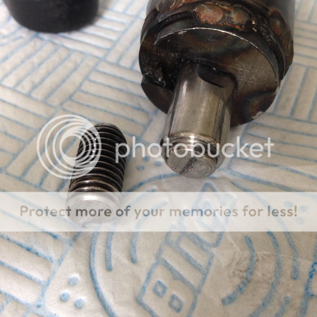

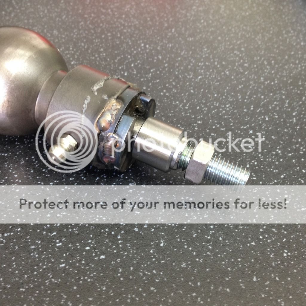

There's a fault with early models, the base pin is made from stainless & will snapped under fatigue as I found out on the way to Santa pod. Later versions have a titanium base with a captive left hand nut holding the gear lever. Basically if you just have a plain nut against the shaft its the early version, its coming loose because the thread is weakening & it will snap eventually, its a crap design.
If it does happen I can repair it fairly easily, so give me a shout or kick off at VS demanding a replacement. I'll post up photos of the later version tomorrow.
Snapped early version
Repair
