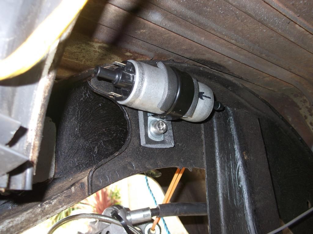

Going to be fitting an electric fuel pump to my van this week and was wondering where the best place to fit it is?
Its a bit tight in there to drill holes for a mount with the electric drill!
Also, which pumps and mounts did you use?
Cheers, Mike

Personally I like the CB rotary vane pumps and dislike the noisy facet pumps.
I mount them on the inside of the gearbox cradle, right up high, with a rivnut most of the time.

cheers - i was literally just looking at the cb performance rotary one.
When you say the gearbox cradle - do you mean the long curved support that goes under the forks and connects up to the body on either side?

Yep.

i have a cb pump to fit, switching from a facet and just stumbled across this thread.
I dont suppose you have a picture of one you fitted do you jim?

Like this maybe ??
