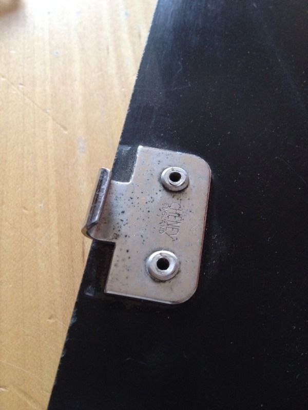

A67 MAN very kindling sent me the missing catch from my cooker top
It looks like it was originally riveted on
Other hinges on the unit where
Has anyone ever drilled one out and put a new rivet in, or should I just screw into the old rivets?
Posts: 14740
Re: LHD 64 Devon Interior
Post by type21f » Sat Apr 21, 2012 5:26 pm
Drill out and replace the straightened catch (put it on the right way round - ask me how I know LOL)

Sorted :) Although I didn't straighten it as it seemed to be angled and I didn't want it too tight to break again

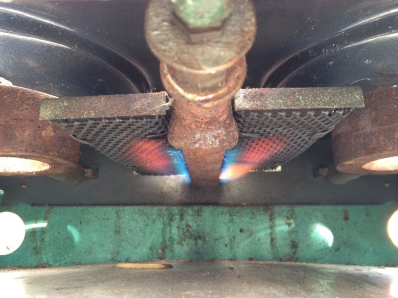

Next questions..
I fired up the Dudley and it seemed to work great, in fact I couldn't believe how much heat came off it!
A totally newbie question for you to laugh at but... whats the centre gas bar for ?? :oops:
maddison
Posts: 5538
Joined: Fri Feb 01, 2008 1:56 pm
Location: up norf
Post by maddison » Sat Apr 21, 2012 7:30 pm
grill
...and yep. who needs a propex

Would you believe I re-fixed one of these today! It's very difficult to drill out the old rivets because they have the end of the steel pin stuck in the rivet so you start drilling and the drill just stops when it meets the pin. I managed to drill mine out using a new expensive 3mm industrial tungsten drill on slow speed. The same is true of the rivets holding the stay on the front flap. Be careful because you need a lot of pressure on the drill to cut the steel so when it gets through the rivet is can shoot through the wood underneath. I did mine using a pillar drill with the depth stop set.

Just as an aside, the catch in the picture below is also used on a Canterbury Pitt table and also to secure the rear facing bench set into folded out position.....anyone know where you can get these catches?
type21f wrote: Image
If the tab bit that you use to slide the catch is slightly bent, whatever you do, don't try to bend it back as it will break off. Ask me how I know this :roll:
