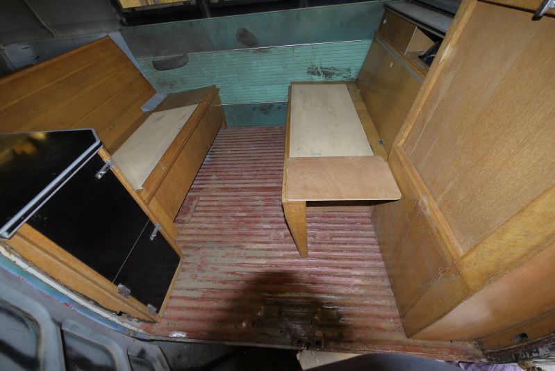

I had a day off today and I couldn't resist having a trial fit :oops:
First the rear drawers
I noticed that the Left hand side fits really snug to the body
but the right hand side is squared off and it sort of looks like it was made that way
I was wondering is this an area to store the table legs?? or should there be something else here?
Also some questions on fitting.. would there have been some felt or padding under this unit? and if so roughly how thick. I can see the odd screw bolts holes in the unit where it goes into the body, what type of screw would have been used? just self tappers?
Next the rear panel this is only temporarily resting It looks to me like it might need to be a tad higher and centralised
Pic from rear showing how its flush against the drawer unit
Cooker unit
I fitted the long side door card which came with the interior (it needs a serious clean!!)
but I wanted to point out something we had previously discussed about the clips along the rear panel, they line up with a hole each end of the long door card showing that it was the water pipe route from the tank and as Graham pointed out it would have gone through the hole on the side of the cooker unit to the tap location.
Rear seat, this was very snug fitting, the cooker and right hand side of the seat is sitting on a bit of 5mm ply and you can see the other side isn't and it 'floating' now just an observation at this point.. should the seats angle downwards at the back ( like a normal seat does ) as the first thing that came to mind is whether the bed is going to be flat? or are the cushions shaped to offset this?
Storage space, note I don't have a heater pipe as mine van was originally a panel van
Sadly the hinge on the rear facing seat has lost its pin, does anyone have a spare or know where I can get one?
Thanks to Graham advise I'm pretty sure this is where the small ply panel goes
This one I wasn't sure on but it seems feasible.. is this where the other piece of ply with the water tank instructions fits?
Lid of the easy cool location
This piece came separately and I noticed something possibly odd about it, maybe it is how they where or maybe its a factory error?
The top part looks like it has been rounded off on the wrong side.. possibly this is just a RHD one but I think it is original to the interior
You can see the lacquer marks and screw holes show it was fitted this way.. maybe this is how they are supposed to look??
Fitted the wardrobe and sort of wedged the slider in place for a picture
How is the rear facing seat and the slider unit attached to the van? does it sit on the water tank? or are there bits of wood missing the parts screw into?
Got the wide angle lens out for a pic of the whole lot (need a taller flash thou!)

Post by maddison » Wed Apr 18, 2012 3:33 pm
thats FREAKIN SHWEEEEEEET !!!!!
8)
slider and rear facing seat top are screwed threw the bulkhead into the wood

so from inside the cab into the slider and rear seat? makes sense :)

yep
