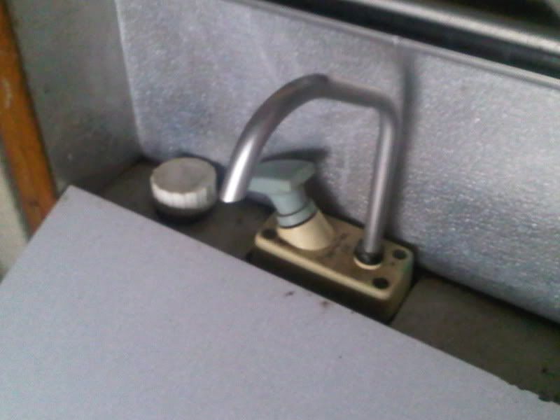

i was hoping to see how does the whale pump is attached?
Can i ask do you have the type pump with a ball handle the left right motion?

I only have a couple of old photos to hand at the moment of the pump.
Never taken the tank out to see how it attaches.
I have seen a few different configurations of the tap/pump/tank tho. not 100% but I think some are plastic containers in the rh cupboard. mine is a 66
Image[/URL]
Image[/URL]
[Image[/URL]

Somewhere in the back of my head I’ve got a feeling that 66 were like this and then 67 had a plastic bottle / tank which could be removed for filling?

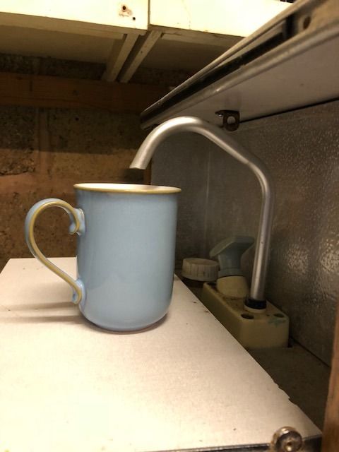

Do you think my tap could be bent as i do not have enough clearance for even a shot glass?

Post by big_al » Thu Mar 15, 2018 2:39 pm
I would say something not quite right lol

I think my tap must have been cut down maybe. You guys think it can be bent up a bit without snapping it?

I believe the spout is thin wall alloy pipe and could be bent.
The risk of bending thin wall is that if flattens and splits.. Hence for bending copper pipe internal spring used to prevent collapse.
Alloy can be harder so risks splitting.
I have not played with mine...
I would want to take the spout out ..get a suitable interior spring for pipe bending and gently persuade each of the bends back to the shape you require.
But internal spring for 15mm pipe is smallest I am aware of.
In the smaller sizes go to external sping.
Tube dims are external
Pipe dims are internal.
See Hamilton gas, they do an external one for 8mm
B&Q do one said to be 10mm..
Not sure of dims of spout.
If Big al can post up or send a trace of the profile..
