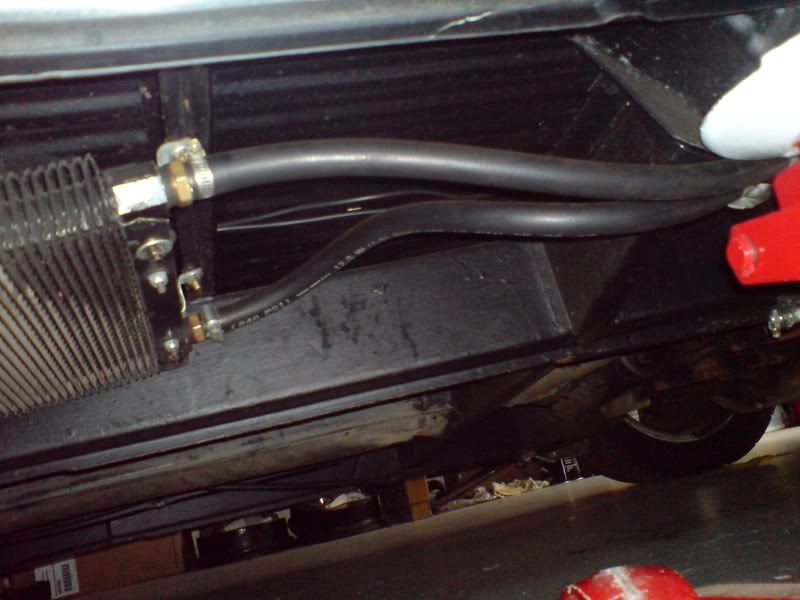

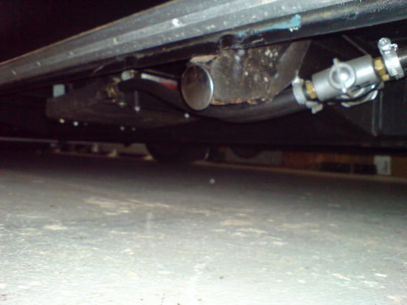

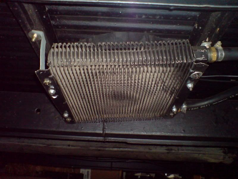

i had mine in the engine bay and it deffo runs hotter although it did do its job but it did get very hot at eurobuggin last year. My engine is out at the moment and i am mounting the cooler and the fan under the bus in between the chassis rails will take some pics if you like.

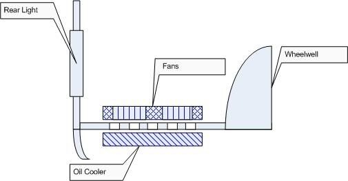

But rather than having the oil cooler in the engine bay , I was wondering about mounting it under the gas bottle tray. There is cool air in the engine bay which the fan would force out as thats the air which cools the engine.
a bit like this

That's better than in the engine bay, but 2 things come to mind firstly exhust heat and secondly stones flicking up from the wheel so would need some protection.

Mine is mounted between the chassis rails in front of the rear wheel, Also angled to draw more air.
Works very well here.
