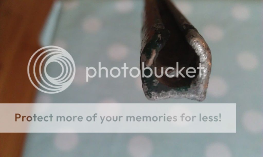

The bottom rail removed from my son's 64 Devon is 157cm long.
It is fitted as low as it will go right against the drain hole shaped indents at the edge of the lower cill.
The front edge against the front wheel arch is shaped so it slopes like the wheel arch.
I would have said that the profile was exactly the same as the upper rail BUT being always in the muck and the salt I think the bottom web sharp edges hasve been corroded away!
The removed rail complete with paint and underseal looks like this!
This does look slightly different but as i say I think this rail was corroded and has been removed before for a new lower cill.

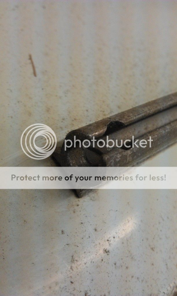

As fitted and never removed to my 65 Devon shows how OG this is rust and crud and all! See the way it is shaped..The other end is square....

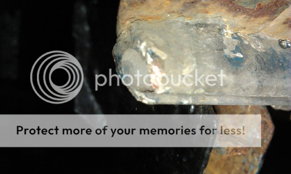

My top rail - which seem to be the same profile as your lower rail. Note also that this has two fixings close together at the front and back. All fixings were a pop rivet.

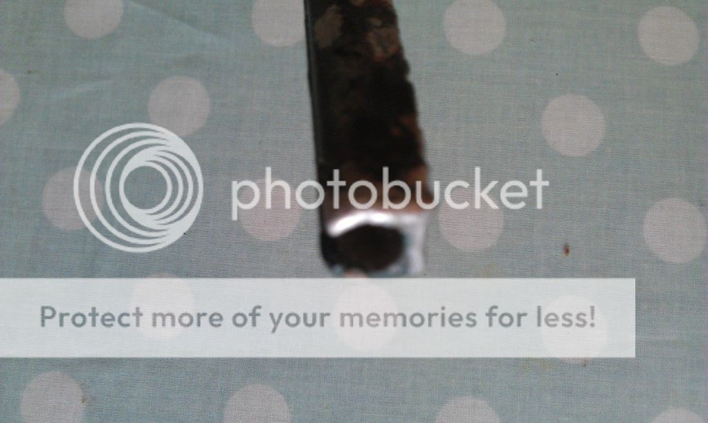

And this is a rail that was sold to me as a lower rail – which may or may not be the case. Perhaps this is from a later date? Anyway, as can be seen, a completely different profile which prompted my question regarding the uniformity of top and bottom rails.
